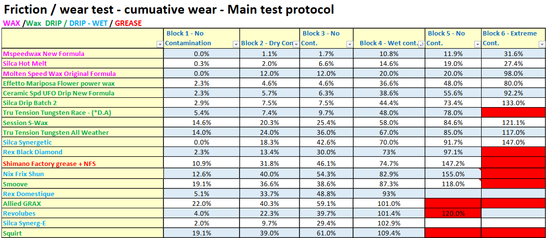

Das Zeug ist das beste, welche sich bisher hatte. Und ich hatte einige!
siehe hier https://www.mtb-news.de/forum/t/wac...ng-ein-erfahrungsbericht.888748/post-18467051
Ja, dein eindruck wird von ZFC untermauert. Danke fürs Teilen.
Wenn jemand nicht Hotmelten will ist das wohl klar die beste option aktuell am markt. Zumindest von den getesteten lubes.
Hast du nen Tipp wo man das zeug günstig bekommt?

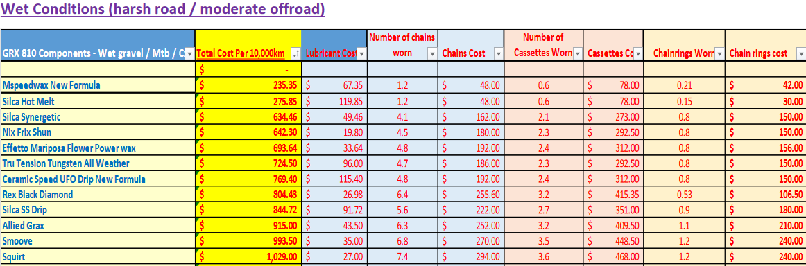

Hab das ZFC review gerade nochmal überflogen. Es ist durchweg sehr positiv. Ich kopier mal ein paar interessante stellen raus:
Kosten:
Und ein Paar Zitate:
ZFC rates Effetto with really the highest rating and recommendation overall especially for dry conditions riding, and an overall very high rating for wet conditions cycling.
it is hard not to be EXTREMELY IMPRESSED with the product that Effetto has brought to market.
Also, Flower Power is priced well in ZFC experience. It is more expensive than say Squirt – but in ZFC opinion it is clearly better in every single way – from not penetration issues to much lower wear in every test block and so much cheaper to run. There is little point saving $10 or $15 on a bottle of lubricant to then pay 10 fold that or more in more rapid component wear.
But it is also much cheaper than say Silca SS drip or UFO drip – and a lot of people just will not pay $50
for a bottle of lubricant. So $29.90 AUD for a lubricant that has set new lowest wear records – that is perfectly priced in ZFC opinion.
In fact, it is the PERFECT lubricant that should be LBS shelves vs the typical Muc-Off and Finish line lubes that tend to dominate the space
