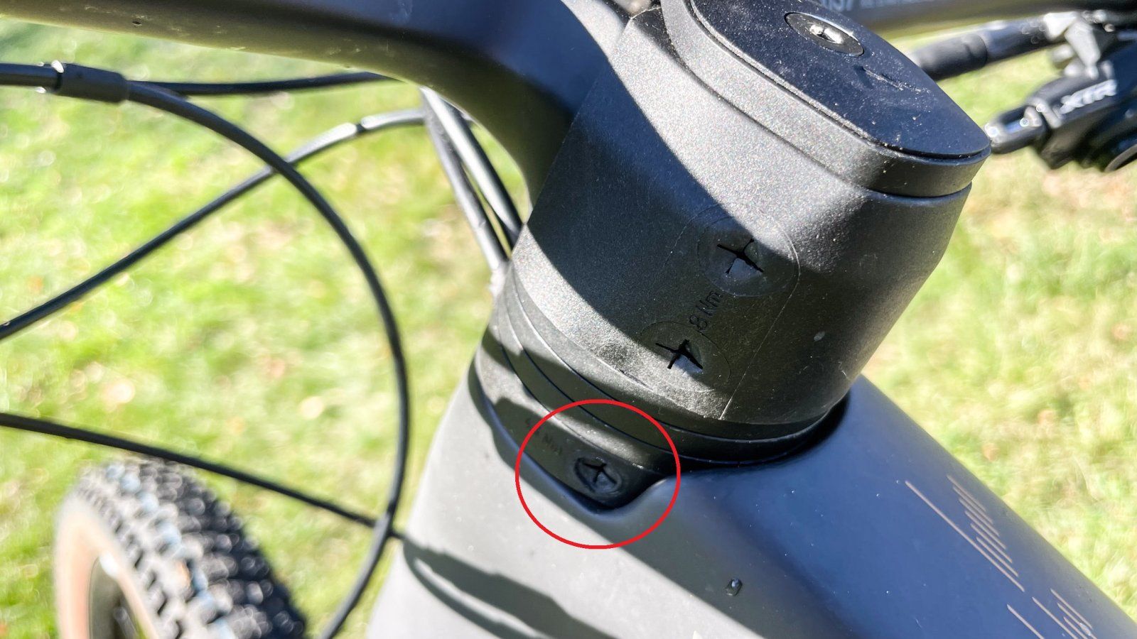

This morning I noticed the hole I have marked in the photo (I got the photo from the internet). What is it for? to tighten the steering lock? It seems strange to me, if it came loose or the stopper was turned by a blow, we would have to disassemble everything because the screw would have moved and it would coincide with that hole. Am I wrong?
That's correct. Good thing is you don't have to cut or open any cables to lift all the spacers and get access to the lock ring. You could also loosen the cockpit just a bit to rotate the plastic cover with the hole to align it with the screw underneath.
