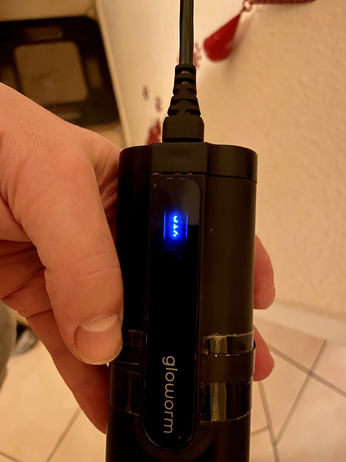

@GlowormLightsNZ Today unfortunately I was affected by a total fail of my G2. It has been working flawlessly since 11.10.2021. After my last ride I arrived at home with 32% capacity shown on the display of the battery. Today I left my house after successfully pairing the light with the remote. Switched it off waiting for sunset. Outside temperature was 10 degrees today. After 35 minutes of riding I wanted to turn the light on. Nothing happened! Only the lower rows of the battery display are working. The battery seems to be totally frozen at 31%. Putting the battery into the warm house and connecting it to the charger did not change anything. I think it‘s dead now?
Is there a possibility for a reset?
Edit:
Factory reset does not work. The light itself is working when connected to the power charger.

@GlowormLightsNZ
Hi Bruce,
any thoughts about my frozen battery problem from post #102 yet?
The battery is still laying around with partially illuminated display like shown above. Nothing did the trick. No charging, no factory reset. The light itself directly connected to the charger is working fine.
Should I send the unit back?

@GlowormLightsNZ
Hi Bruce,
Try to wake it up using a 'dumb charge'. This can be achieved with using a normal USB C charger that is not USB PD. A charge from a laptop or PC would also do the trick. The key is that cable should terminate at the power source with a USB Type A connector.
If this doesn't work, email us at [email protected] and we'll arrange a replacement.
Cheers
Bruce
Dumb charge didn‘t work. Tried an older apple charger and an old universal USB type A charger. No success. Will send a mail to GW support considering replacement. 🤔

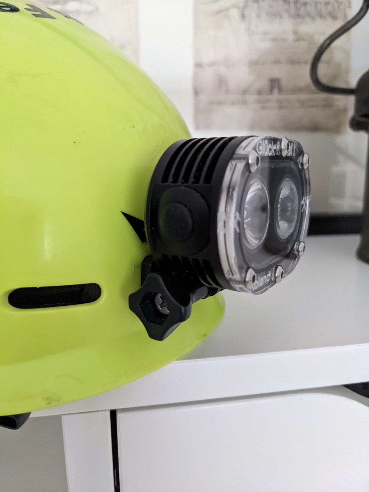

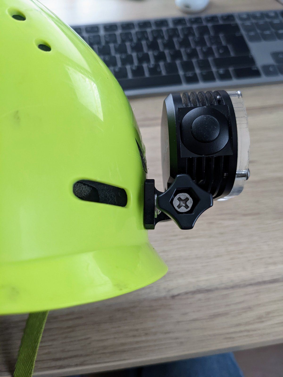

Und noch eine Frage: wie funktioniert der Go-Pro-Mount bei der Lampe? Da konnte ich auf den Bildern nicht wirklich erkennen.
Super, danke! Ist mir nicht aufgefallen. Aber dann hat sich die erledigt, mit dem System kann die nicht vorne an den Helm geschraubt werden. Schade.
Warum ist genau das so wichtig? Also was genau hast du damit vor?
Die Lampe ist echt gut, von den Problemen abgesehen, die hier schon aufgezählt wurden (und die hoffentlich mit dem Firmwareupdate gelöst werden). Falls die Lampe sonst alle Anforderungen erfüllt, würde ich auf jeden Fall auch etwas eigene Bastelinitiative in Erwägung ziehen. Das Lampengehäuse lädt durchaus dazu sein, außer den kleinen Gewinden unten gibt es auch noch ein größeres seitlich (eigentlich für die Kopfhalterung per Gurt). Wenn man etwas frickelaffin ist, dürfte man die Lampe so ziemlich überall hin und dran bekommen.
War auch als Ersatz für die Helmlampe gedacht. Dort ist ein go-pro Halter dran, aber das funktioniert nicht, wenn an der Gloworm die Befestigung unten drunter ist. Dann müsste man den Lampenkopf weit nach oben drehen können, siehe Bilder.
in diesem Review gibts Bilder von einer Gloworm mit GoPro Halter. Was spricht denn dagegen, eine kurze GoPro Verlängerung an den Helm zu machen?
