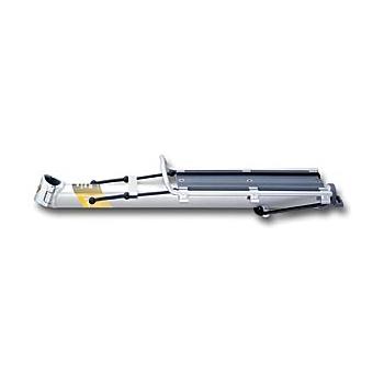

Gepäckträger Topeak RX BeamRack gerade Ausführung http://www.comparestoreprices.co.uk/images/to/topeak-qr-beam-rx-rear-rack.jpg,
