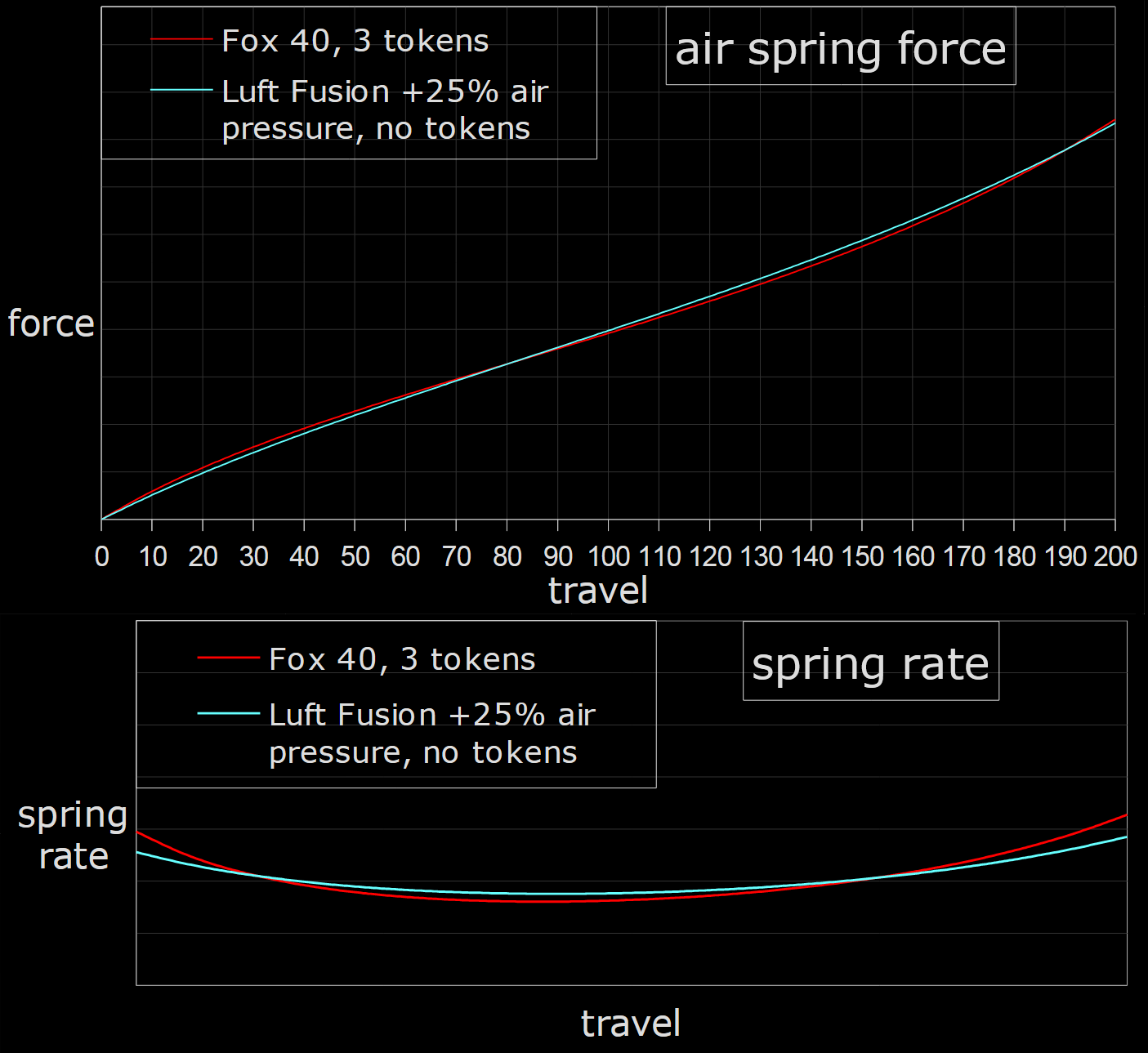

it's park season and the Luft Fusion air spring is now available for:
Fox 40 2016+, Marzocchi Bomber 58 2019+
Rockshox Boxxer 35 2019-2022
