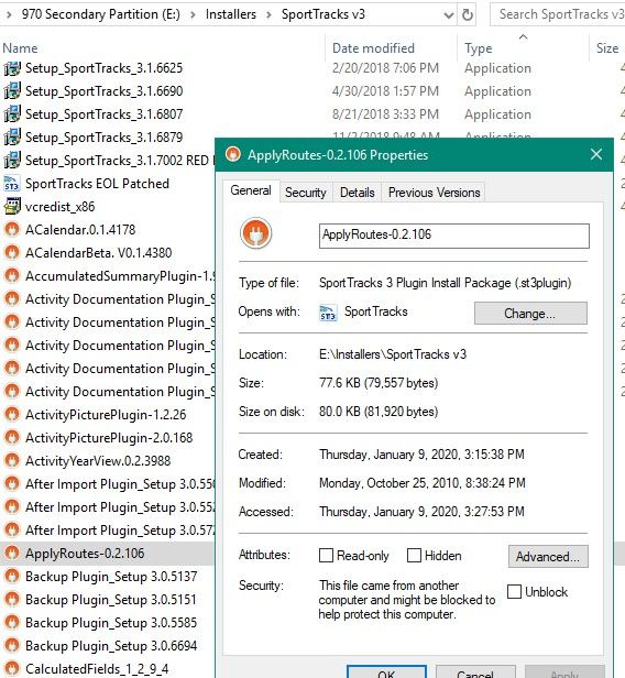

Running on Win10/64 with no issues about associated filetypes. I did a clean install of all elements of ST3 when I moved from Win7/64. Note I am running a Win10/64/LTSC install.
See below image.
I think you need to unlink your filetypes from ST3 and then relink them so
.logbook3 and .fit open ST3; and
.st3plugin opens ST3 for plugin install.
This might require a windows uninstall and reinstall, possibly with a registry clean.
