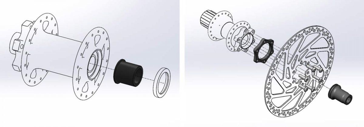

Hier gibt es Boost-Adapter für einige DT Swiss und Hope Naben.
  • Boostinator DR – $39.95 shipped – Available now
    • The Boostinator DR is compatible with DT-Swiss 12x142mm Star Ratchet (240- and 350-series) rear hubs with 6-bolt (IS) rotor mounts.
    • Centerlock hubs are not supported.
    • The Boostinator DR is also compatible with some complete wheels from DT Swiss, Roval (Specialized), Giant, Syncros (Scott), and others that use DT’s Star Ratchet internals.
  • Boostinator DF3 – $24.95 shipped – Available early Feb. 2016
    • The Boostinator DF3 is compatible with DT-Swiss 15x100mm 350 and 370-series front hubs.
    • Centerlock hubs are supported.
    • The Boostinator DF3 is also compatible with some complete wheels from DT Swiss.
  • Boostinator HR – $39.95 – Available Late Feb. 2016
    • The Boostinator HR is compatible with 12x142mm Hope Pro2 hubs.
  • Boostinator WR – $39.95 shipped – Available Late Feb. 2016
    • The Boostinator WR is compatible with White Industries 12x142mm MI6 and XMR hubs.
    • The Boostinator WR is also compatible with some wheels, such as those from Rolf Prima, that use White Insustries hubs.
The front hub conversion is simply a single spacer that pushes the entire wheel away from the driveside. This means it works with Centerlock or 6-Bolt up front. The rear uses a single hub spacer that pushes the entire hub towards the driveside in order to maintain proper cassette position. A 6-bolt disc rotor spacer then pushes the rotor back into the proper spot for your caliper, but means it won’t work with Centerlock hubs.
For the front wheel, Lindarets has developed a longer axle end cap that will go on the drive side of the hub. This modification will require a re-dishing of the front wheel in order for the rim to be centered properly in the fork. It’s a fairly simple task that your local shop can knock out in no time if you’re not comfortable doing it yourself.
The rear wheel is a little more involved. In addition to a longer axle end cap–in this case on the non-drive side–there is a spacer that will mount behind the brake rotor to provide proper alignment with the caliper. Lindarets also provides longer bolts for the rotor since the standard ones will be too short to use.
Rear Boostinator kits are not approved for rotors larger than 183mm!
http://www.singletracks.com/blog/mtb-gear/news-lindarets-announces-the-boostinator/

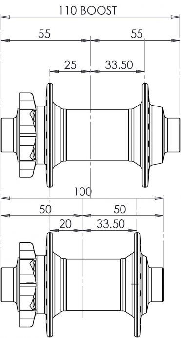

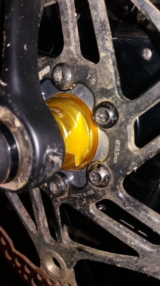

Hi, von Hope gibt es auch entsprechende Adapter: z.B. für vorne "hope hub1009-14n". Macht für 11€ aus ner 100x15 ne 110x15 Nabe.
Hat das schon mal jemand gemacht? Ich kann keine Bilder finden und frage mich ob
V1: die Nabe 5mm nach links geschoben wird und man dann die Felge 5mm nach rechts zentrieren muß
oder
V2: Die Nabe in der Mitte bleibt und die Bremsscheibe 5mm unterlegt werden muß?
Zu Gunsten einer symmetrischen Einspeichung wäre V1 durchaus sinnvoll:
EDIT: V1 stimmt. Die Felge wandert und die Speichenlänge links und rechts sind damit gleich. Funktioniert bei mir bestens.

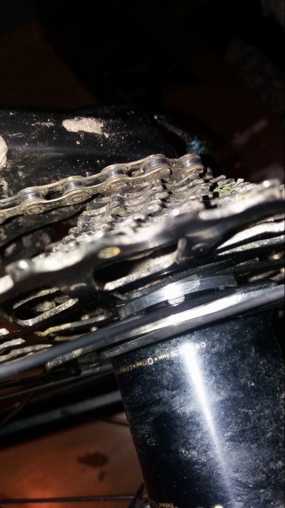

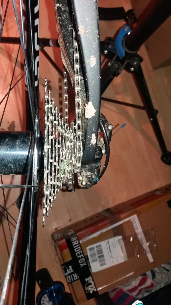

E13 TRS+ Hinterrad von X12 auf Boost. Kassette sieht eigenartig aus an der Position aber passt ohne die Schaltung zu verstellen
