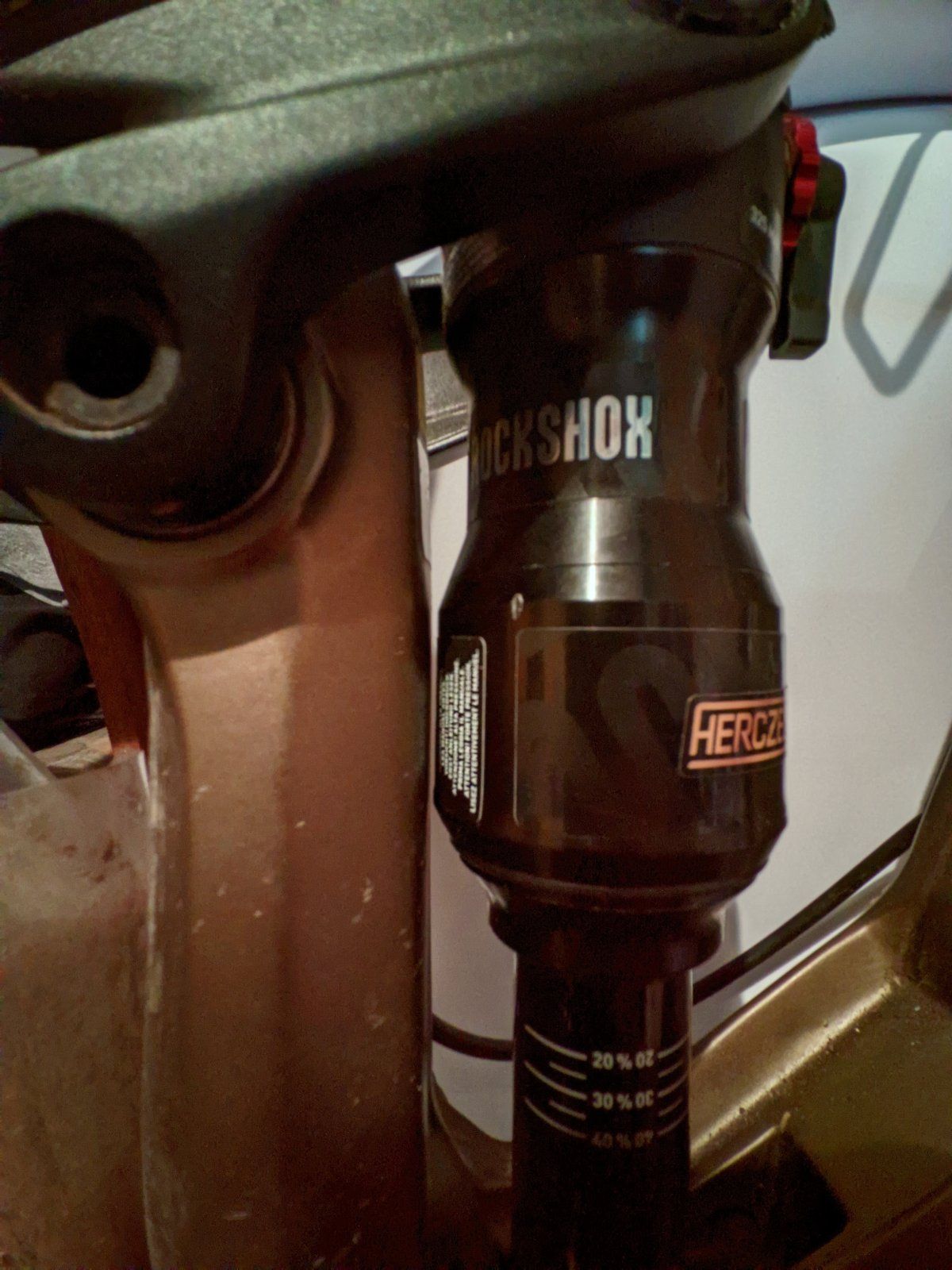

Has anyone tried a Megneg on their Slide/Skeen? I'm wondering if it would fit, from what I understand it's as big as some coils.
So if anyone is wondering, a Megneg fits... Just. The shock rotates forward as the suspension goes through it's travel, so you do gain a bunch of clearance, but i'm still not comfortable running it like this.

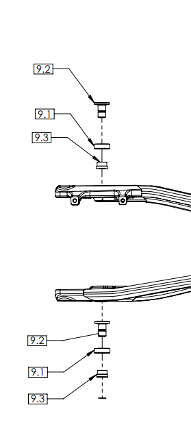

I was just doing some maintenance and cleaning and noticed that the bearing at the drive side chainstay pivot point is loose in the frame. I can literally pop it in and out with my fingers. Even when the bolt is tightened the chainstay can still shift a bit, since the bearing isn't supported from both sides like most other bearings on the frame, and it's only held in by the press fit (which isn't a press fit anymore). Wrote Radon, we'll see what they say, i'm just curious if anyone had the same issue. I check my pivot bolts regularly, these never even came close to loosening, probably because there is such minimal rotation at this pivot.

I had the same problem. The bearing was just pressed in and popped out after a parking lot bunny hop. This caused the rear triangle to disintegrate. Quite dangerous if this happens on a trail.
The Radon support said this was changed on later models and sent me a new rear triangle together with the Horst link set for the left side.
"Guten Morgen,
bitte entschuldige die entstandene Problematik.
Dieses Problem lässt sich relativ leicht beheben.
Benötigt wird auf beiden Seiten das Horst-Link Set für links. So wird es jetzt auch serienmäßig ausgeliefert.
Sollen wir den Umbau durchführen, oder sollen wir dir ein Set zukommen lassen?
Sind sonst noch Teile beschädigt? Sollte das neue Set nicht korrekt passen, würden wir die Sitzstrebe natürlich mit austauschen. "

The attached drawing was sent to me by Radon illustrating how the horst link should be installed.
Thanks, familiar with how everything goes together, unfortunately that's not the issue.
Contacted Radon, after a week went by I sent them another email. They got back to me after the second email saying they will ask the manufacturer for replacement parts, but said that it might take a few days to receive an answer. That was a week ago, no reply yet.
This pivot point is an "interesting" design for sure...

BTW Radon sent me new seatstays due to the loose bearing. It took ~2-2.5 months but at least I got something. I'd urge everyone to use Loctite retaining compound when installing bearings at the next service. Such a stupid design.

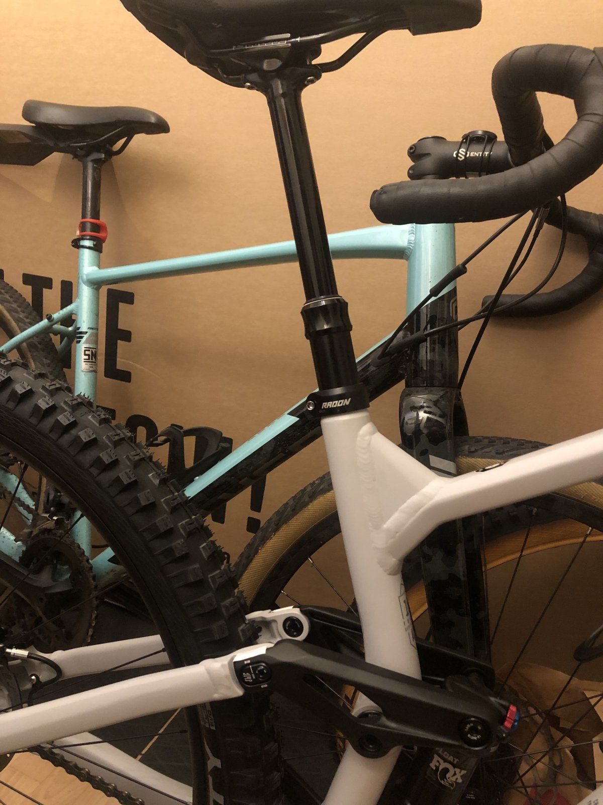

Ich habe gestern den Slide Trail 8 AL in Größe M erhalten. Ich bin 1,77mtr SL 83 cm.
Laut der Größentabelle von Radon liege ich zwischen Größe M/L.
Das Komische ist, dass die Variostütze (150 mm) in Größe M viel zu hoch für mich ist. Wenn die Sattelstütze so weit wie möglich im Rahmen steckt, komme ich mit den Zehen gerade noch auf den Boden. Hat noch jemand diese Erfahrung gemacht?
Und wäre es wegen des gekröpften Sitzrohrs anders in Größe L (auch mit 150mm Variostütze)?
Danke im Voraus für die hilfe (Entschuldige wenn mein Deutsch nicht optimal ist, bin Niederländer in Berlin).
Innenbeinlänge * 0,885 = Sitzhöhe von Tretlagermitte bis Satteloberkante.
