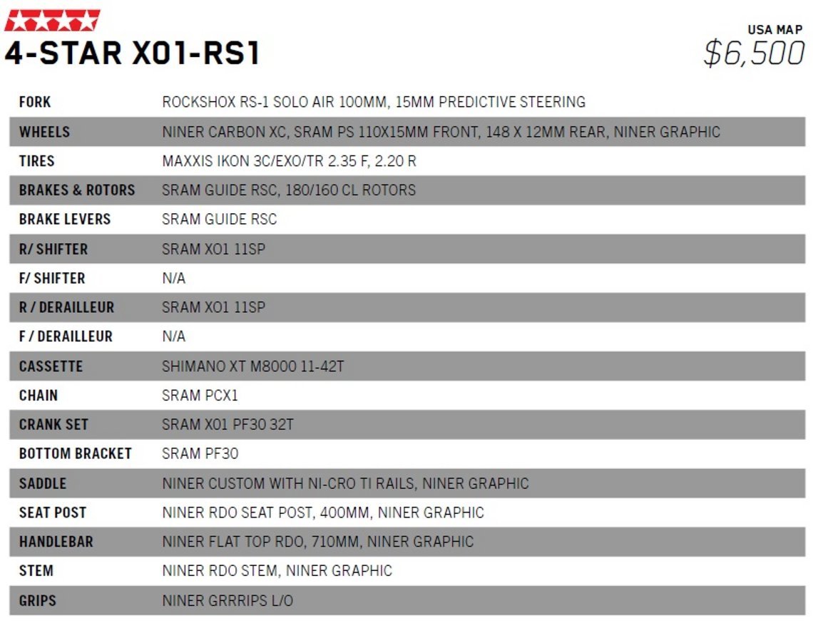

Niner Air 9 RDO 4-Star X01 RS1
# Niner Air 9 RDO 4-Star X01 RS1
