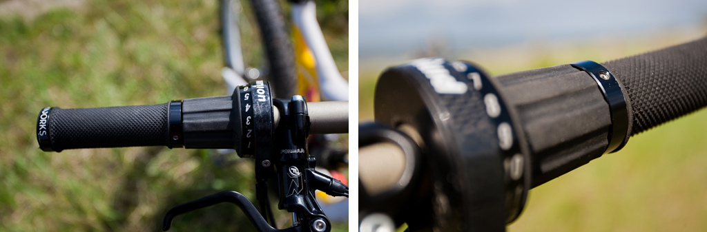

    Twist-grip Shifting
    First time on the bike and heading out, you notice that you can just jump on it and ride. That is important. If you’ve used a gripshift system before then the Pinion's shifting system will be very familiar. Those who haven't, don’t be afraid. Twist-shift systems work quite well - SRAM wouldn’t have bought them back if they didn’t. People who worry about twisting the shifter when they pull on the bars either haven’t used gripshift, or set their bike up badly when they did. The single twist shifter moves through all 18 well spaced gear selections in sequence, with a reported, 600-percent spread from lowest to highest - a greater range than you would get with a 3 x 10 derailleur drivetrain and without any of its overlapping or duplicate ratios. Being able to move through every gear with a single shifter is one of the big advantages of the system: easy access to such a wide range.
    What the twist-shifter does mean is that you have to think about brake lever positioning, especially if you have small hands. Most current brake-lever systems are based around triggers which mean they can be run close-in to the grip. With the barrel of the twist shifter in the way, smaller-handed riders may struggle to properly reach the blades on some brakes, like the relatively short-bladed Formula set that were mounted on the test bike.

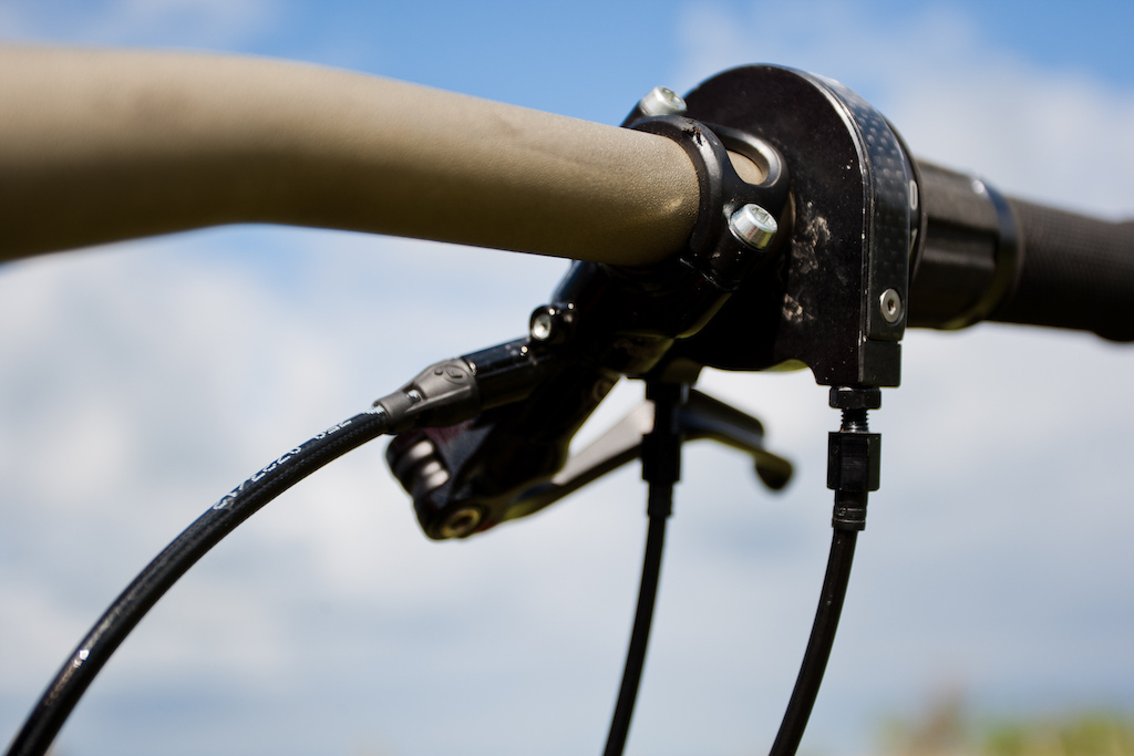

    [Bild] That shifter. Unlike any current mountain bike system, the Pinion gearbox needs two cables to operate its rotary shifting mechanism - this is one of the reasons why a conventional thumb shifter wouldn't work with the P1.18 gearbox.
