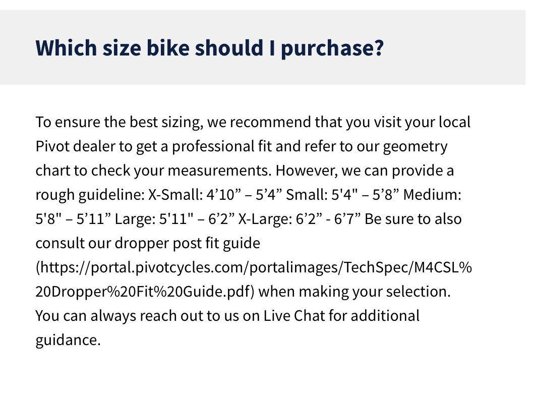

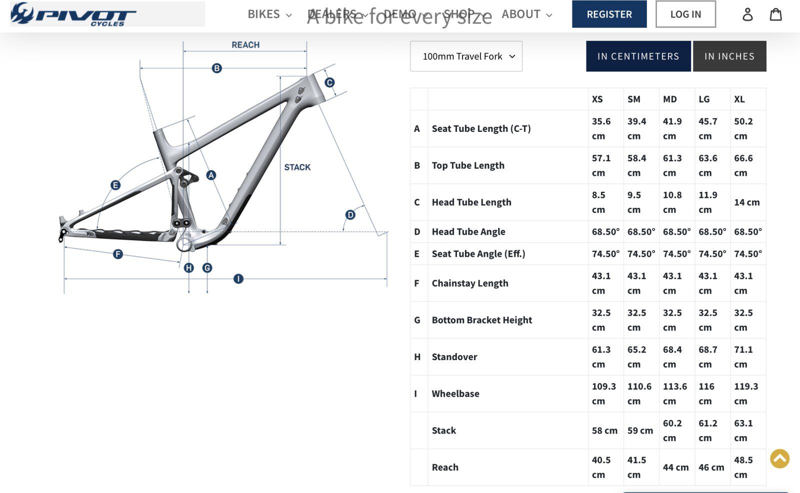

Pivot Mach 4 SL comes in a size XS with big standover height. Not cheap though.
