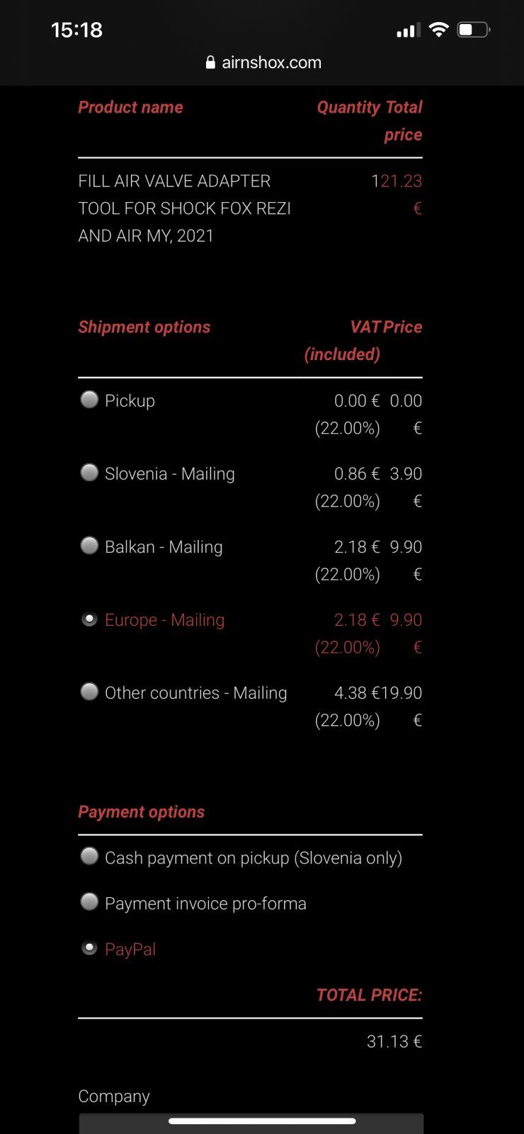

https://airnshox.com/product.php?id=2052Hier "available" ☝️
31,13€ incl. Versand aus 🇸🇮
